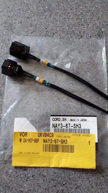

If you've decided to fit a set of the genuine fender lights as supplied by MX5 Parts, MX5 Parts Side Fender Set it's difficult to find some suitable connectors for the bulb holders. There is a genuine Mazda item that you can use, Part # NAY3-67-SH3, from memory they're about £13 each but with seal the connector properly to prevent water ingress.
