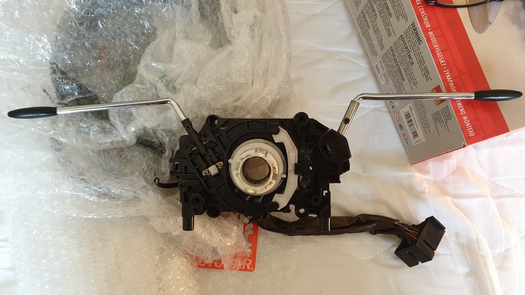

Post by fivedriver on Apr 20, 2023 16:29:51 GMT
Hello folks. After a bit of a hiatus I've picked this project back up Here's how the stalks look today. ![](https://i.postimg.cc/yNxqqWmw/20230420-163911-2.jpg) Next job will be to add a plug to the headlight wiring before fitting the assembly in the car. I will need to make sure everything works before I instal it though. Cheers, Guy
Post by RS on Apr 20, 2023 16:50:57 GMT
Nice one Guy....keep the progress coming.....
Post by Roadie on Apr 20, 2023 18:10:55 GMT
Looks bl**dy lovely.
Post by goonz on Apr 20, 2023 18:42:26 GMT
spot on....well done
