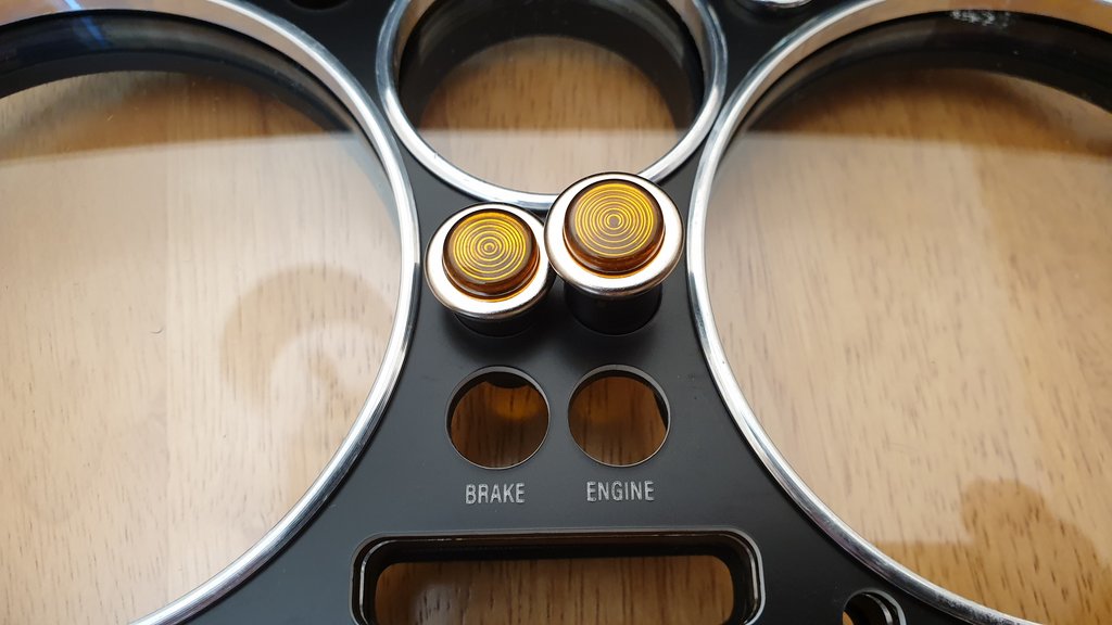

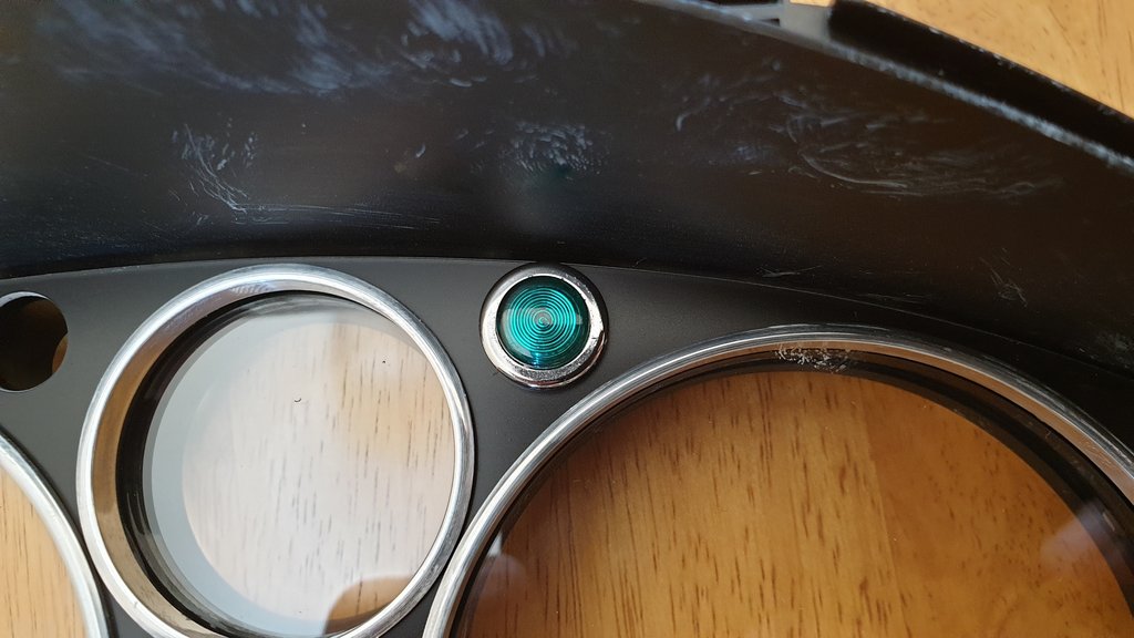

Hello all, May I share my next little project with you please? I received a package this morning from a company called "Laser dash". ![](https://i.postimg.cc/kXf2mwmX/20230520_141418.jpg) You may have seen these before. It contains a new dash insert that resembles individual dials. ![](https://i.postimg.cc/bJxvF9gP/20230520_170501.jpg) ... The original design allows for two alternative warning lamp designs. I've been chatting with the company owner and after a bit of discussion he kindly made me a custom design to accept Lucas warning lamps that match those I'm using elsewhere in the car. You can see an indicator just to the right of centre above the dial. ![](https://i.postimg.cc/j2qR30C6/20230520-142705-2.jpg) The lamps are illuminated by the OE lights in the cluster. Replacing the warning lamps with the Lucas items has thrown up a challenge though. ![](https://i.postimg.cc/QM5NHJR7/20230520-142656-2.jpg) The chrome rims clash. My plan is to ease the lamp holder on one edge to allow it to slip across +/- a mm. Hopefully that will allow the lamps to nestle neatly next to one another. Failing that, I'll have to make the mounting hope a tad oval. Watch this space.....

How about sawing it off immediately behind the bezel. Just leaving the bezel and lens. You could probably refix to the tube section slightly offset.

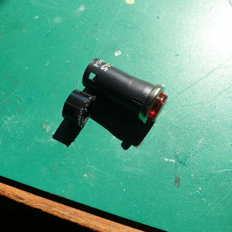

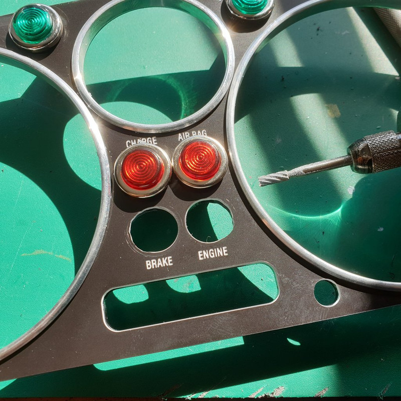

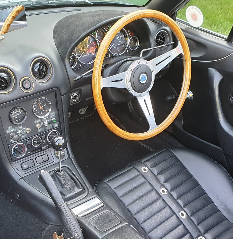

Hi folks. With the sun shining down I decided to tackle the new dash. After attempting to ease the lamps over by trimming the plastic bulb holder I eventually used a dremel style tool to elongate the holes. ![](https://i.postimg.cc/HxqQPSWB/20230527-161249.jpg) This allows the lamps to squeeze in. I was also forced to trim each bulb holder in length. ![](https://i.postimg.cc/R0PdGQnD/20230527_152945.jpg) The lamps are illuminated by the existing bulbs. ![](https://i.postimg.cc/909BW6g6/20230527_164828.jpg) Here's how the whole assembly looks. ![](https://i.postimg.cc/tC05rgYp/20230527_165825_2.jpg) It's still beautifully sunny here so once I've eaten I'll take her for a spin and bring you my thoughts. Cheers, Guy

All looks so good. Everything has gone together beautifully and the dash panel is spot on. Love it. Only thing I can see that might make it even better is the loose gaitor around the gear lever. A black plastic end cap fitted in the gaitor with a hole for the stick would do the job. End caps

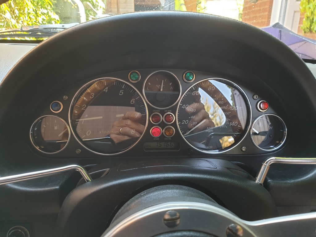

After a few miles around the block these are my first impressions. It's colourful. Not used to that. It's not a bad thing just,....different. Reflections. More than before. Again, not a bad thing. It's easy to see why Mazda designed that curved acrylic front piece that all but eliminates said reflections. However, what it does do is feel more old fashioned. Exactly what I was looking for. The tell tale lamps are not very bright as they rely on light being bounced through black tubes from the original bulbs. They're visible in low light conditions and when the top is up they're easier to see too. I'll spend more time with her before deciding whether anything needs to be done. I can live with it as it is but would it be better if I could see the indicator and handbrake telltales in all conditions?🤔 So all in all I'm happy. It's another step in the right direction. Earlier today I discovered I had won an Ebay auction for a Smiths vacuum gauge so attention may well turn in that direction very soon. Cheers, Guy
